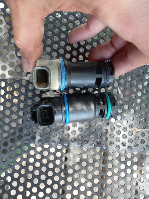

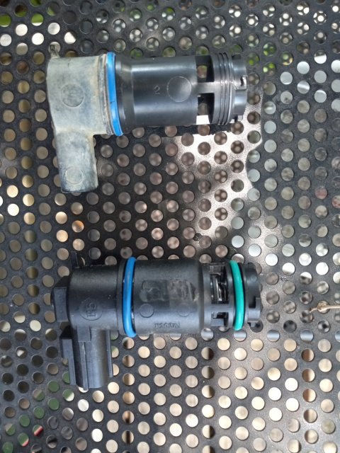

Cvs20 purge solenoid
hey Andy I did not have C.E.L , as I deleted that code when the pcm was flashed and it was actually a dirty filler neck mouth ,had...

Mercurios2011
Handy Andy's post
Excellent find! So some valves are Integrated into the canister - so you throw it all away and get a fresh one. The Valve exists, but...

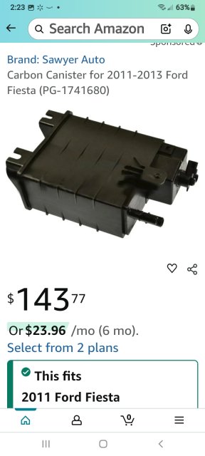

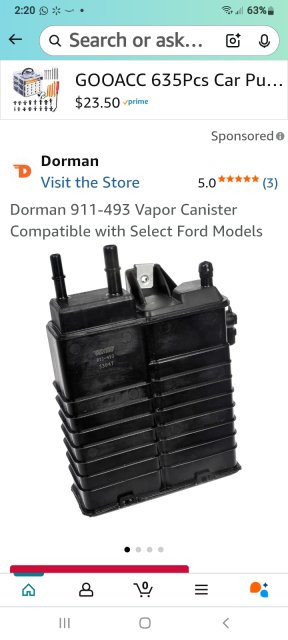

Mercurios2011
Seem it was as I feared ,not all 2011 Have a vapor/charcoal canister removable solenoid some are built into it. Low and behold here is...
