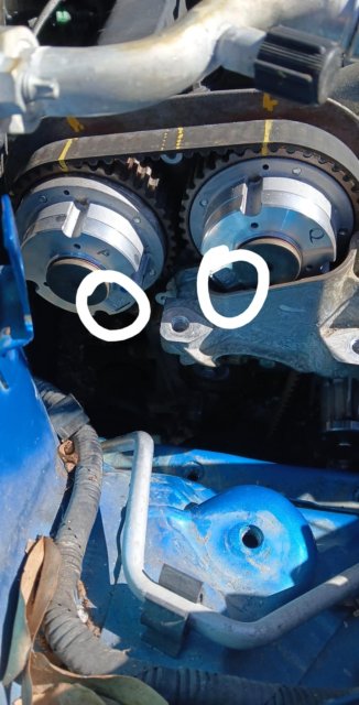

HELP Timing issue (I think) 2015 Ford fiesta SE 1.6
So I stuck a screwdriver i spark plug cylinder hole #1 till it was all the way up cranking the crankshaft, and once it was at top dead...
Jan 18, 2026

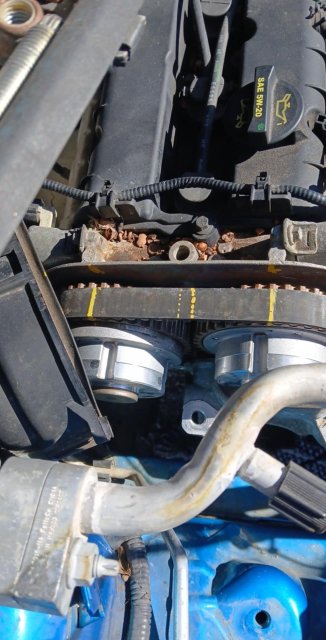

J
Julianj
I was starting to think the same thing, I didn't mess with any electrical connectors though, when I first cranked it after getting it...
Jan 17, 2026
J
Julianj
I have it all apart right now, I hand cranked the motor a few times and both cams on top line up perfectly. So I don't know what the...
Jan 17, 2026

J
Julianj
I recently did a water pump replacement on a 2015 Ford fiesta. The first time everything went well started right up, but the shitty...
Jan 16, 2026
